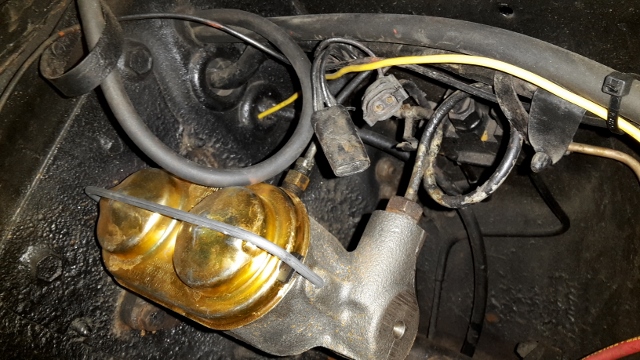

Re: 67er Coupe bremst nicht mehr
Verfasst: Mi 29. Mär 2017, 19:14
von lordperth
Noch ein
2017-03-29 18.56.38 (360x640).jpg (216.54 KiB) 1441 mal betrachtet
e kurze Nachfrage: welches von beiden ist wahrscheinlicher? : :)
Danke!
Verfasst: Mi 29. Mär 2017, 19:44
von Braunschweiger
Der obere, der mit dem Halteklip.
Der gummierte sollte für die Haubenblinker sein, ein Extrazubehör.
Verfasst: Mi 29. Mär 2017, 22:45
von lordperth
Braunschweiger hat geschrieben:Der obere, der mit dem Halteklip.
Super, danke! Much appreciated.

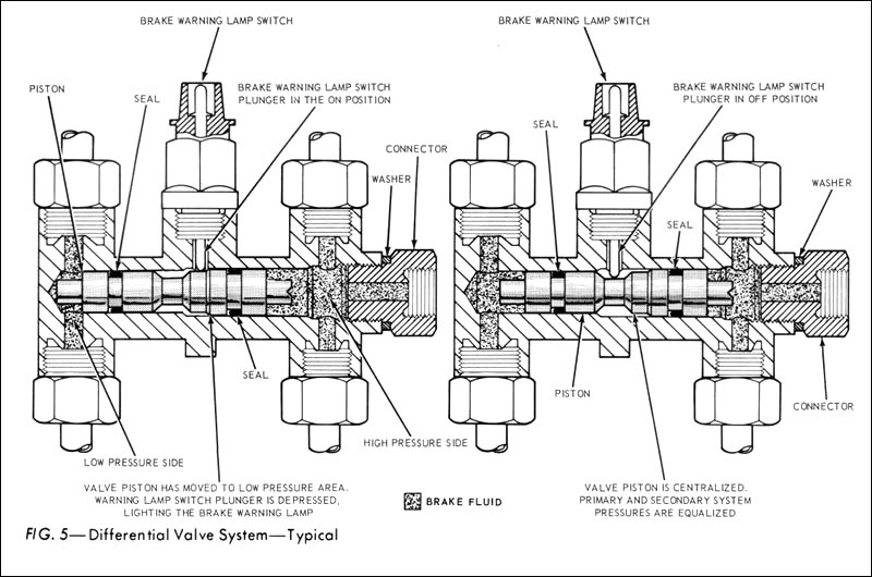

Verfasst: Mo 10. Apr 2017, 18:57
von Schraubaer
Nicht nötig!
"Centralizing The Pressure Differential Valve
After a failure of the primary (front brake) or secondary (rear brake) system has been repaired and bled, the dual-brake warning light will usually continue to be illuminated due to the pressure diffenterial valve remaining in an off-center position.
To centralize the pressure differential valve and turn off the warning light after a repair operation, a pressure differential or unbalance condition must be created in the opposite brake system from the one that was repaired and bled last.
1. Turn the ignition switch to the ACC or ON position. Loosen the differential valve assembly brake tube nut at the outlet port on the opposite side of the brake system that was repaired and/or bled last. Depress the brake pedal slowly to build line pressure until the pressure differential valve is moved to a centralized position and the brake warning light goes out; then, immediately tighten the outlet port tube nut to the specified torque.
2. Check the fluid level in the master cylinder reservoirs and fill them to within 1/4 to 1/2 inch of the top with the specified brake fluid, if necessary.
3. Turn the ignition switch to the OFF position.
4. Before driving the vehicle, check the operation of the brakes and be sure that a firm pedal is obtained."
